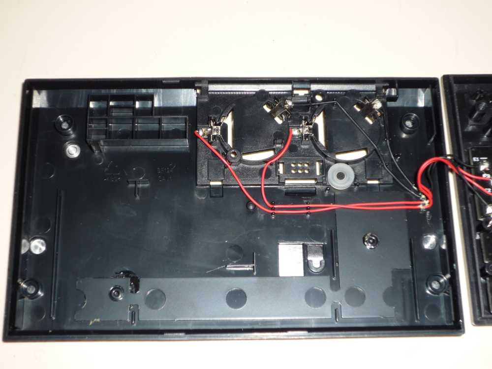

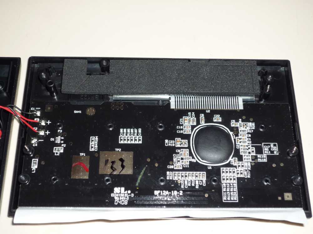

Has anyone looked inside their battery compartment for the programming interface? I didn't really see anything in those pictures TW posted a few days ago.
Will we be able to flash the 15C LE if we need too?
Thanks.

I'm sure that it uses the same PCB as the 12C+ and there is no JTAG connector.

Re: Does the 15C LE have a 6-pin JTAG connector?
Message #24 Posted by Mike Morrow on 10 Sept 2011, 12:56 p.m.,
in response to message #2 by Katie Wasserman
Thanks for the pictures. Somehow, the internals of these new speed demons don't have the beauty of the original Voyagers, especially after those were cleaned up with the single PCB design.
