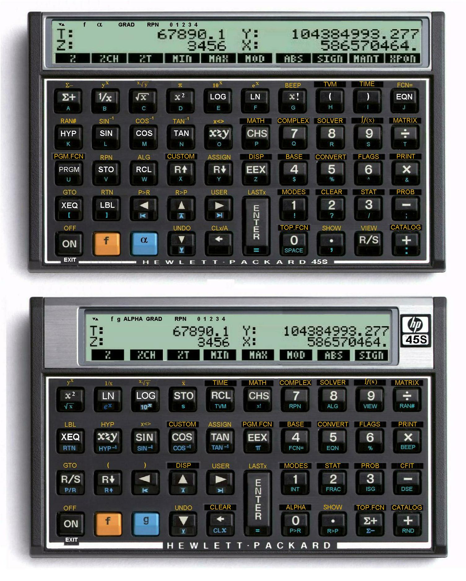

For what it's worth, Gene and my "HP45S" was first created in February of 2006. It was named "45S" as a combination of the 15C and 42S, and originally was attempted to fit in a Voyager case.
[img:http://www.pahhc.org/2007/HP45S-5 v20 -4 V17.jpg]
The idea was to have a wide LCD with eight or ten soft keys and both are shown here. Richard Nelson got into the act soon after and suggested also attempting the same functionality in a Pioneer case, and the result was posted by Gene earlier.
Jake Schwartz

Gotta hate spaces in filenames!
