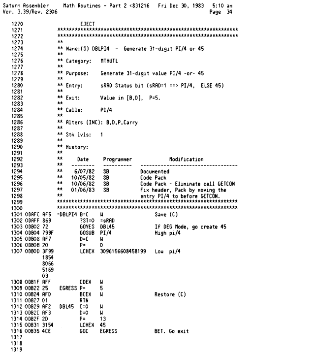

This behavior is well known and has been discussed in the past, see for instance here.
And as an evidence of the double-precision pi value in Saturn machines, here is an extract of the HP-71B source code (the first Saturn machine, and the only one with public source files):
[Image: pi_31dig.png]
In the same Math routine module, there are double-precision arithmetic functions to do the argument reduction.
J-F

(02-01-2015 08:41 AM)J-F Garnier Wrote:  the first Saturn machine, and the only one with public source files
Could you provide a link where we could access them?
Many thanks in advance
The HP-71B IDS documents are available on the MoHPC DVD (or USB drive now).
