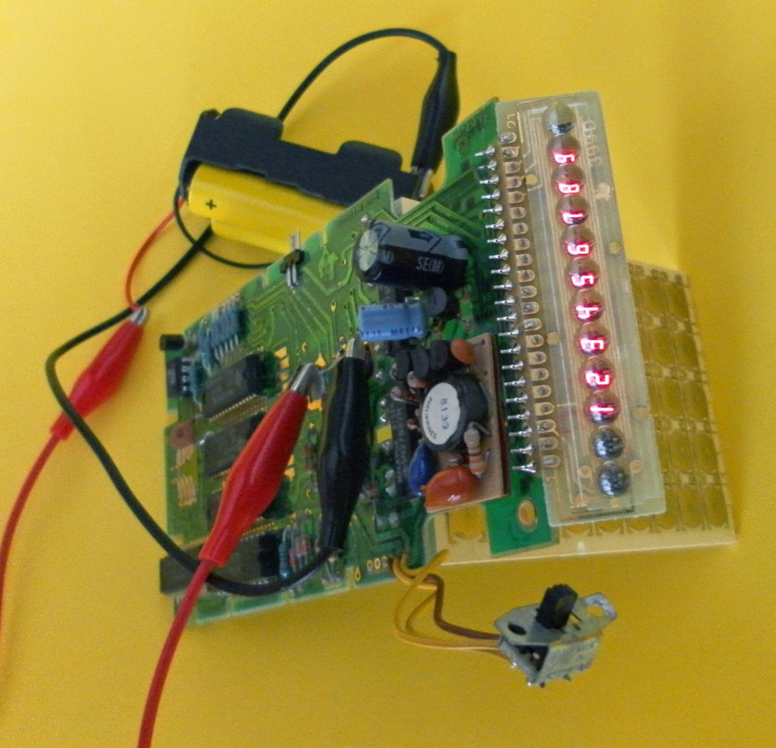

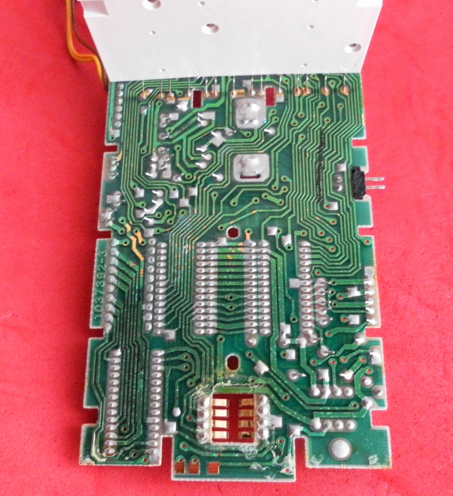

I have this Texas TI-58C that is not able to store in any of the registers or program codes.
Otherwise, the calculator operates normally and all the math and scientific functions gives the expected results. The previous owner left the batteries inside and it leaked badly. I have dismantled the machine piece by piece, put everything in the kitchen sink in warm water and dish soap for 15 minutes, then used a soft brush to remove the battery remains from the PCB and plastics. Two days later I powered it on and it worked normally, except that it doesn't store in the registers or in the program steps. Just get zeros when reading. I am not able to find the service guide or the schematics, so I'm looking into the PCB traces and try to figure out its architecture. There are some information in the Internet concerning the TI-58 and TI-59, including the service guide, but these share little with the TI-58C at the hardware implementation, despite being very similar at the architecture level. Does anyone has this documentation on the TI-58C and willing to share or sell? 1) For this TEXAS TI-58C from 1981 (ATA3381), the main PCB components are:
It seems that the registers and program area are sharing a common storage sub-system based on two IC's (TC5047AP-1 and TMC0591NL). 2) A few things I have checked: 2.1) I have recorded the current consumption to be about 220mA, which seems on the high side for me, but I do not have another machine to compare. 2.2) The voltages from the DC-DC converter power supply for the Texas IC's are fine:
2.3) The power supply for the SRAM TC5047AP-1 is fine (reading taken while powered ON):
2.4) The SRAM backup power supply (470uF cap.) looks fine as well (reading taken while powered OFF):
Basically, the Capacitor positive terminal is connected to the +Vbatt (this is the common return), while its negative terminal is fed by two power supply sources:
3) So, I believe that the SRAM chip may be faulty. Why? Well, I do not have the required equipment to do the circuit analysis to be sure, but:
I'm ordering a replacement SRAM chip from China. Wait and see from now on. 4) Some pictures from the internals: ![]() ![]()

Power supply voltage sources:
![]() Master Library 1 diagnostic results:
As expected, the Diagnostic fails. Jose Mesquita RadioMuseum.org member |
