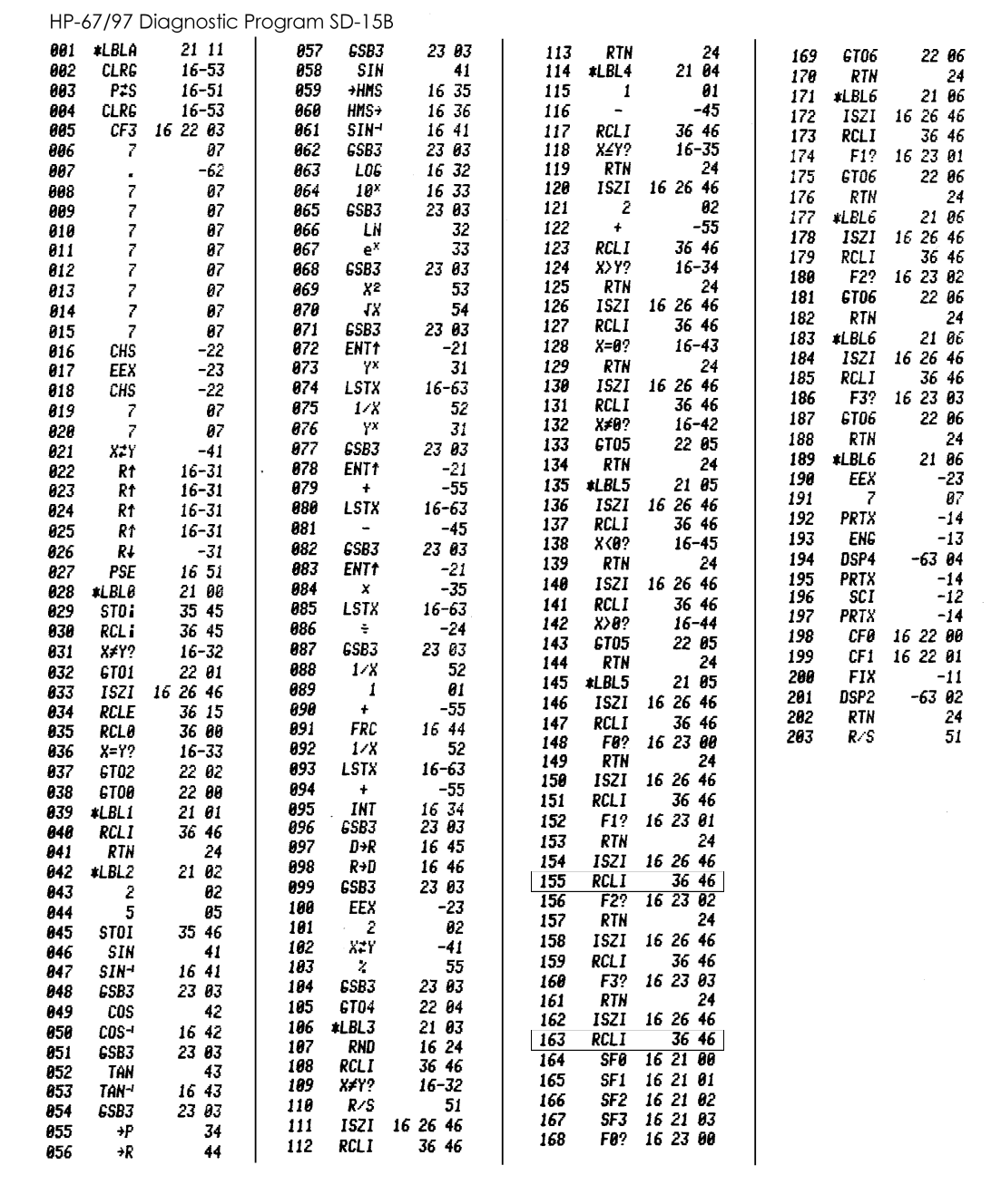

RE: HP-67/97 SD-15B? - vassilisprevelakis - 03-06-2017 01:06 AM
(03-05-2017 04:41 PM)AndiGer Wrote:  a SD-15B card is out there?
Yes there is and here is the listing:
[Image: HP67-SD-15B.gif]
Now the funny thing is that I vaguely remembered seeing an SD-15B listing somewhere, so I googled that and I got back the image above from my own website!

RE: HP-67/97 SD-15B? - Gene - 03-06-2017 03:45 PM
Hey vp, give that link to your website for people who may not have it.
Nice clear text!

RE: HP-67/97 SD-15B? - AndiGer - 03-06-2017 05:37 PM
Dear Vassilis,
Thank you for your quick answer and the listing. Compared to the SD-15A version only the boxed 2 statements in lines 155 and 163 are different.
I laughed very much when I read you found on your own website.
Today I found a post from you in the old forum with a link to extracts of the manual in the old forum:
http://www.prevelakis.net/HP67/HP-67-Diag.pdf
The listing itself is new to me. Thank you for posting.

RE: HP-67/97 SD-15B? How about SD-15C? - Willy R. Kunz - 03-08-2017 04:13 PM
Interesting. I just noticed that the Diagnostic Program included with my RPN-67 and 97 simulators is actually SD-15C, not SD-15A, as stated. SD-15A is being offered, too, but only in the German version.
And now we also have SD-15B. Time to clean things up, both in the simulators and on the homepage...
Note that SD-15C is quite different from the almost identical versions A and B.
