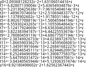

RE: Lambert W function (for HP Prime) - lyuka - 11-02-2020 09:53 AM
Whether it's practical or not, I was interested in higher-order convergence methods,
so I wrote a function to calculate LambertW using Householder's method of order 4.
[Image: eqn-LambertW-quartic.png]
The convergence test by Urabe's theorem is used to determine the convergence.
It is a method to judge that the calculation limit has been reached and terminate
the iteration when the correction value does not change or increases.

Example of fourth-order convergence
LW0H(3) → 1.04990889496403995998869707...
#iteration, t, y
0, -- , 1.08724606477
1, 3.73371212519e-2 , 1.04990894352
2, 4.85551153205e-8 , 1.04990889496
3, -4.97651234081e-12, 1.04990889496
Example of convergence check by Urabe's method
LW0H(-1e40+1e40*i) → 87.9726013585729060233240600422... + 2.32971836088312317016079031477...*i
#Iteration, t, y
0, y = 91.2594742667+2.35619449019*i
1, t = 2.58701135424 +9.47329698771e-3 *i, y = 88.6724629125+2.3467211932 *i
2, t = 0.698946120062 +1.68949509172e-2 *i, y = 87.9735167924+2.32982624228*i
3, t = 9.15433828888e-4 +1.07881392113e-4 *i, y = 87.9726013586+2.32971836089*i
4, t = 2.77222531883e-11+9.83926571672e-12*i, y = 87.9726013586+2.32971836088*i
5, t = 2.45892275992e-11-5.24426278827e-12*i, y = 87.9726013586+2.32971836089*i
6, t = 2.77222531883e-11+9.83926571672e-12*i, y = 87.9726013586+2.32971836088*i
In this case, the convergence test (|t6| > |t5|) by Urabe's method worked well.
Please refer to the page below for details.
Lambert W function and exponent of Lambert W function for HP Prime

By the way, in extreme cases such as x = -1.78, iterative calculation of about 16 times is required for any of Householder method of order 4, Halley's method, and Newton-Raphson method to converge. In this case, the state of convergence is not chaotic but very slowly and monotonously.
LW0H(-1.78)
[Image: LW0H-slow-convergence-at--1.78.png]
lambertw(-1.78) by WolframAlpha is,
0.089218049856209317716109060765294251305387407793167833503833064... +
1.6256236744277681331520891017303249073577948841857860157186500... i
As a convergence decision in such a case, I wonder whether I should wait for convergence or stop the calculation when the appropriate accuracy is reached.
Though it depends, it seems too much to do 16 iterations for a calculation result of less than 12 digits.

Quote:By the way, in extreme cases such as x = -1.78, iterative calculation of about 16 times is required for any of Householder method of order 4, Halley's method, and Newton-Raphson method to converge. In this case, the state of convergence is not chaotic but very slowly and monotonously.
This has less to do with the algorithms, and more to do with HP Prime.
CAS side only have 48-bits precision (bottom 5 bits used internally).
Worse, rounding is *biased*, toward zero.

(11-04-2020 08:12 PM)lyuka Wrote:  LW0H(-1.78)
We may detect chaos faster by measuring actual corrections of y, instead of t's
Assuming above numbers is base-10, 12 digits precision:
y1 = y0 - t1 = 0.0892175267236 + 1.62562359481*i
y2 = y1 - t2 = 0.0892180498540 + 1.62562367443*i
y3 = y2 - t3 = 0.0892180498555 + 1.62562367443*i
Imaginery part converged. Real part of y, ULP = 1e-13
y4 = y3 - t4 = y3 + 11 ULP
y5 = y4 - t5 = y4 + 9 ULP
y6 = y5 - t6 = y5 + 7 ULP
Chaos detected going from y10 to y11. Correction = 2 ULP = previously.
W(-1.78) ≈ y10 = y3 + (11+9+7+5+4+3+2) ULP = y3 + 41 ULP = 0.0892180498596 + 1.62562367443*i
Here is proposed patch, for LW0H, Rev 1.36 (Nov 5, 2020):
    y := y - t / v;  // Householder's method of order 4
    t := abs(y - p); // correction radius
  UNTIL 0 == t OR (r < 1 AND r <= t); // convergence check
  return p;
END

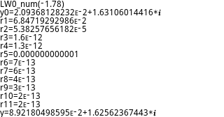

In the following cases of x = -1.78, the calculation results were all
correct up to the 12th digit in CAS, but not in HOME.

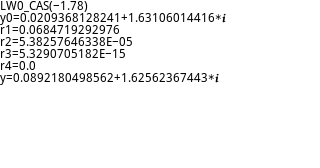

LW0 Rev.1.38 convergence example at x = -1.78 at HOME
[Image: LW0_num-1.38-convergence-at--1.78.png]

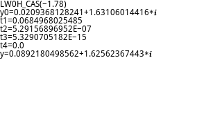

LW0 Rev.1.38 convergence example at x = -1.78 in CAS
[Image: LW0_CAS-1.38-convergence-at--1.78.png]

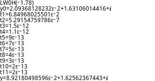

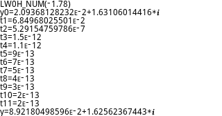

LW0H Rev.1.37 convergence example at x = -1.78 at HOME
[Image: LW0H_num-1.37-convergence-at--1.78.png]
LW0H Rev.1.37 convergence example at x = -1.78 in CAS
[Image: LW0H_CAS-1.37-convergence-at--1.78.png]

  PRINT;  // clear terminal
  PRINT("LW0_CAS("+x +")");
  PRINT("y" + n + "=" + y);
  r := 9;
  REPEAT
    n := n + 1;
    p := y;
    q := r;
    t := exp(y);
    s := y * t;
    t := (1 + 0.5 * y) * (s + x) + t;
    IF (0 == t) THEN break; END;
    y := y - (y + 1) * (s - x) / t; // Halley's method
    r := abs(y - p); // correction radius;
    PRINT("r" + n + "=" + r);
  UNTIL 0 == r OR (q < 1 AND q <= r); // convergence check
  PRINT("y=" + p);

RE: Lambert W function (for HP Prime) - Albert Chan - 11-07-2020 01:42 PM
(11-07-2020 07:36 AM)lyuka Wrote:  Calculation result by WolframAlpha --
W0(-1.78) ≈ 0.089218049856209317716109060765294251305387407793167833503833064… + i1.6256236744277681331520891017303249073577948841857860157186500…
This convergence behavior in HOME may be due to the fact that 12 digits are not large enough, but,
it's similar to the behavior when there is a problem with normalize-and-rounding for each numerical calculation.
HOME mode imag part rounded up to is 1.62562367443, error = true - approx ≈ -0.22 ULP
However, imag part ULP is 100 times real part ULP.
HOME> y := 8.92180498562ᴇ−2+1.62562367443*i
HOME> y * e^y
−1.78-4.1692ᴇ−12*i
HOME> y := 8.92180498602ᴇ−2+1.62562367443*i
HOME> y * e^y
−1.78-1.276ᴇ−13*i
It may be why HOME mode iterations gravitate to the second number.

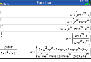

RE: Lambert W function (for HP Prime) - lyuka - 11-08-2020 08:07 PM
[Image: HP-Prime-Graph3D-LambertW-mag.png]
Programs using the Householder's method were only a few percent faster than those using the Halley's method for their computational complexity.
It seems that the difference between cubic convergence and quaternary convergence is not so much in the calculation of about 14 decimal digits.
For now, the CAS version of the program LW0C using Halley's method seems appropriate because of its stability, accuracy, speed and simplicity.
