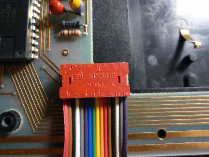

Hereby some pictures about he HP97 revival progress made so far :
I just fixed the printer paper advance issue by replacing the cracked old elastomeric friction wheels by sections of rubber tube just pressed in. To do so i had to desassemble completely the printer mecanism shafts. It was not difficult. Cleaning and added some silicon oil on the wheels and shaft. Works as new now.
I disassembled the battery pack and its NiCd obsolete cells from ... 1986 that were showing high internal resistance and ordered some fresh NiMh same size cells from a vendor in Italy. Just waiting for the delivery.
For now, the 97 is working from a bench power supply connected via crocodiles to the battery connectors.
Hereby the missing display segment (5 instead of 9) and the printer fix before/after :
And an high tech home made independant battery charger :
