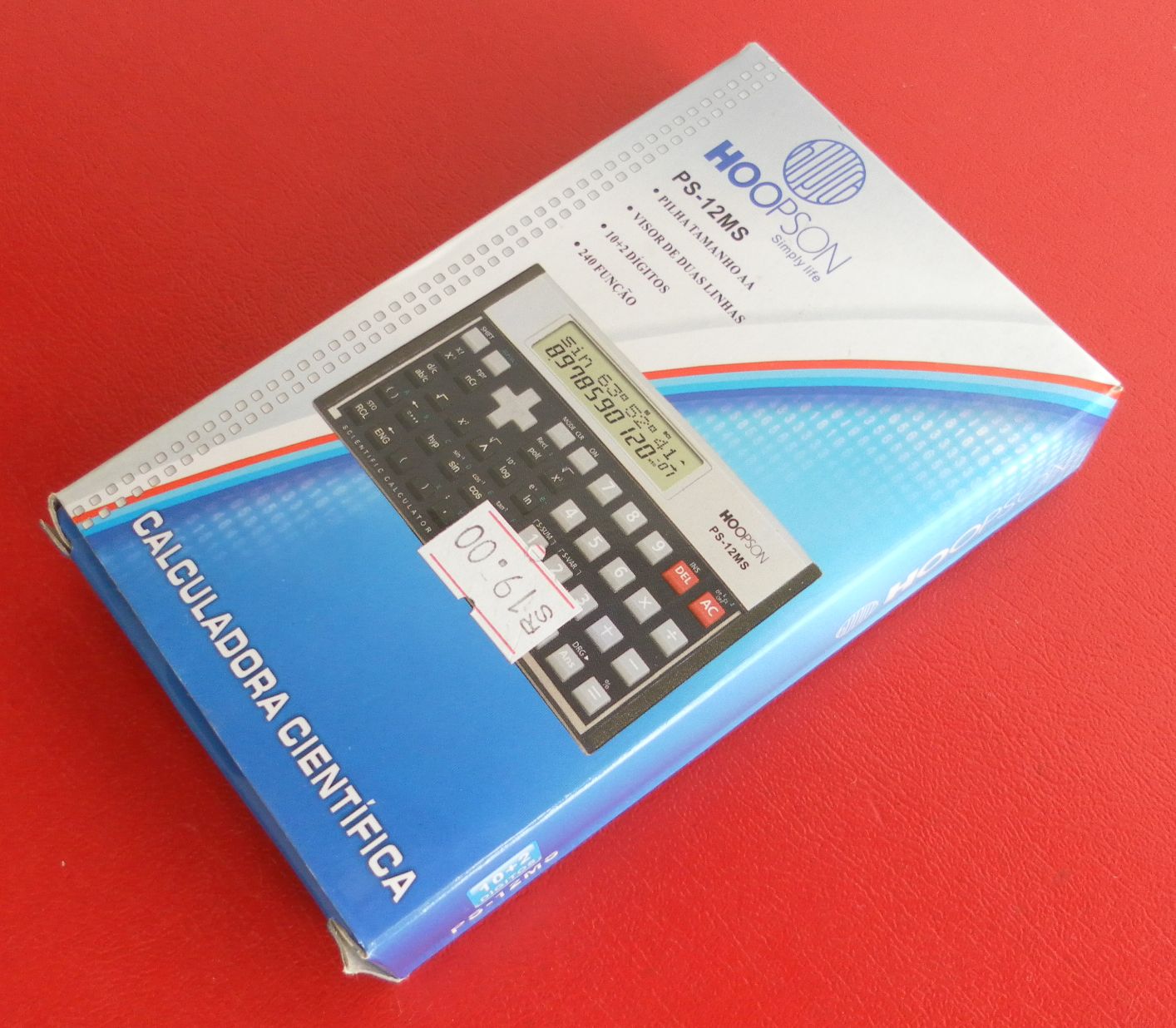

Not remotely an HP calculator, but...

Wow, very collectible!
Now we know where came HP inspiration to make the Voyagers...
But wait, it's not RPN....not programmable...never mind...
And what for "replay"?????
09-08-2017, 04:19 AM
RE: Not remotely an HP calculator, but...
Alpha supports A-F, X, Y and M ????
Still, looks nice a decent CASIO clone.

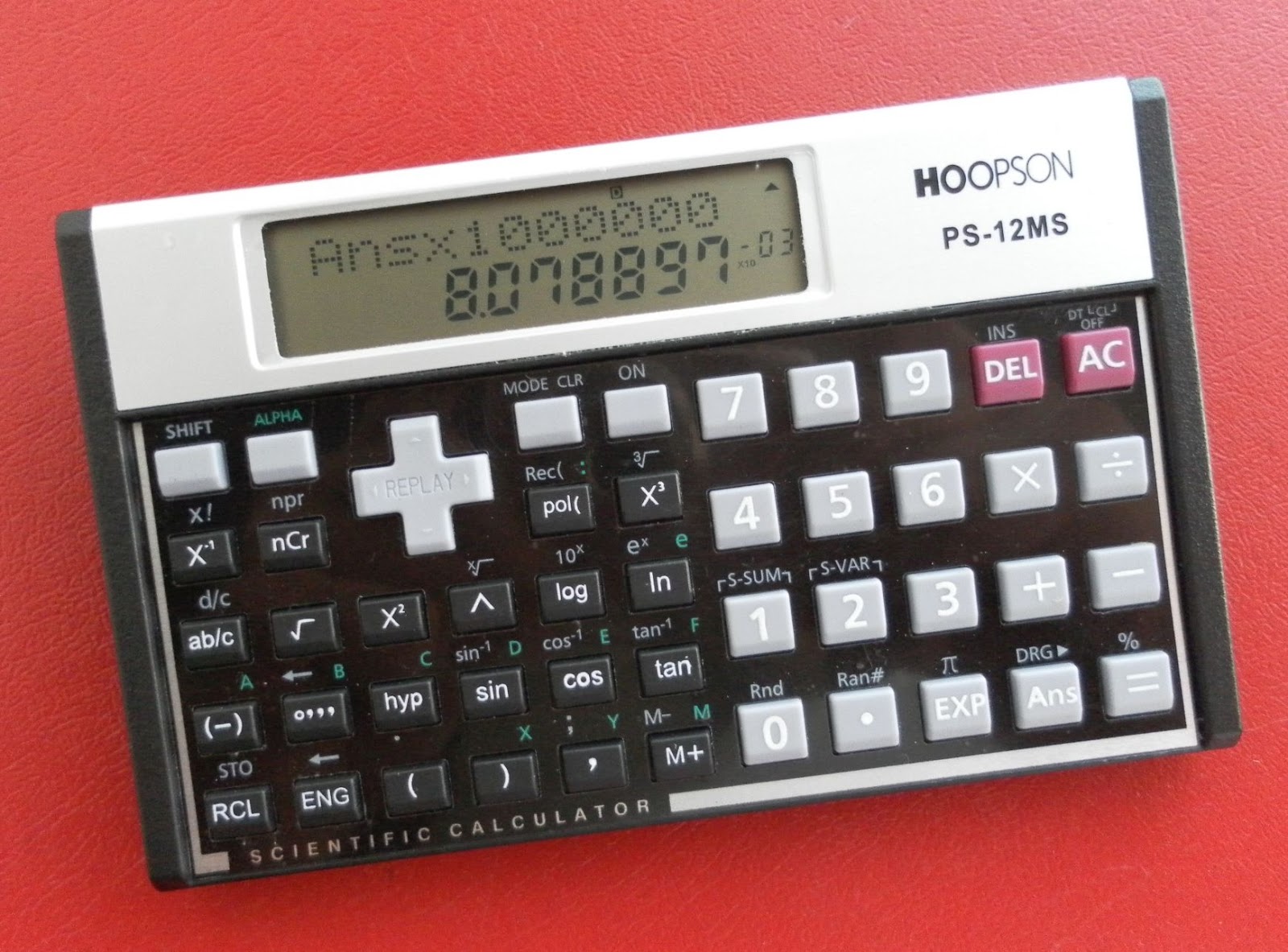

But the Mike Sebastian's Calculator Forensics test reveals a different beast inside, so it doesn't seems to be a exact clone.
This calculator seems to be able to work with 16 BCD digits internally, as the test result was 8.999999998078897 after extracting the remaining internal digits, and this result is different from the Casio signatures.
A quick Internet search for 8.999999998078897 forensics shows just a few machines with the same signature:

Forensics test - extracting the remaining digits.

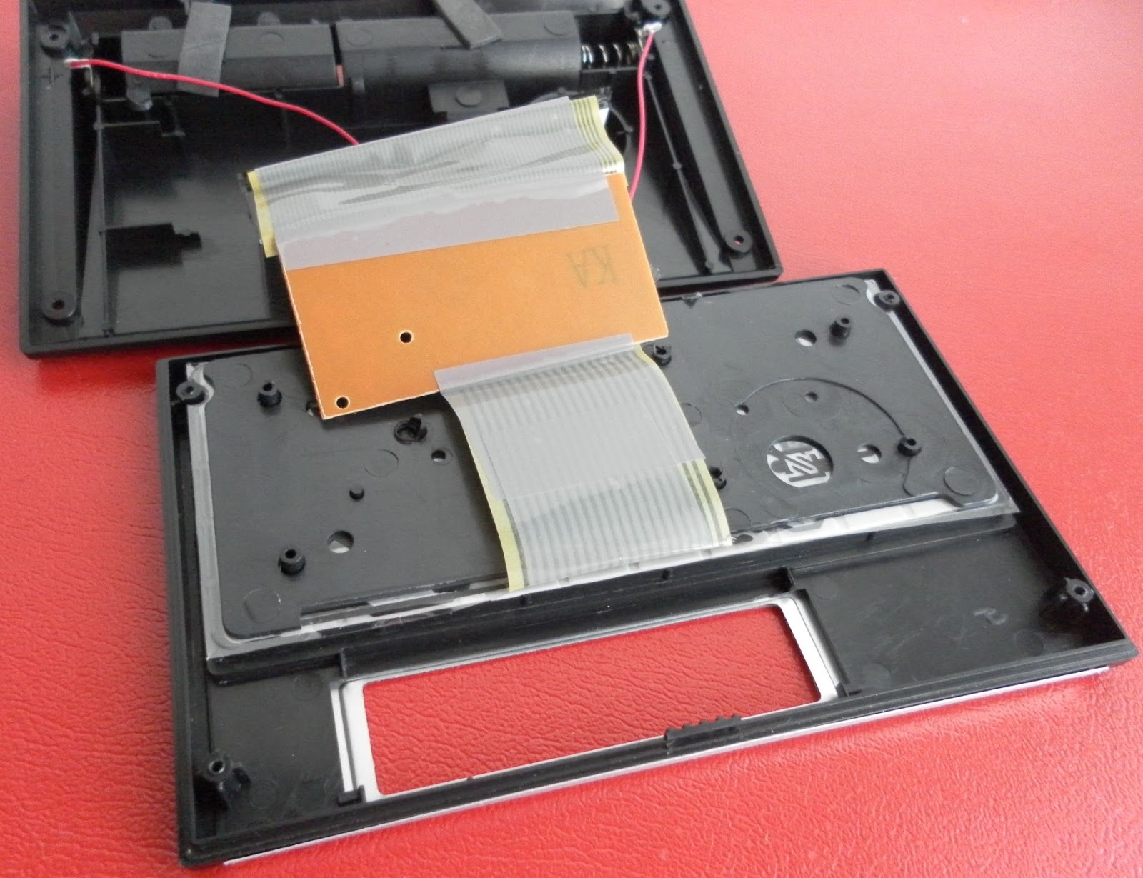

And of course my preferred activity: Dismantling the machine to see what's inside.
The back cover maintains the LCD display and the processor board in place.
Four small metal self taping screws need to be undone to remove it.
[Image: SAM_3970.JPG]
Mainboard PCB label: 82MS-9-2 13.06.14
After removing the back cover, the mainboard PCB and the LCD display are floating around.
Flexible flat cables interconnect the keyboard and display to the mainboard assembly.
The membrane keyboard is fixed using undone plastic rivets. Didn't try to dismantle it.
Reset key contacts on the left of the mainboard PCB assembly.
