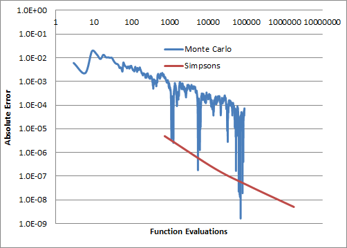

Message #21 Posted by Crawl on 19 Dec 2011, 8:35 a.m.,
in response to message #1 by Namir
Both methods work well, with the nested Simpson method performing better than the Monte Carlo for the same number of function calls.
Monte Carlo eventually wins, because the error goes as 1 over the square root of the number of function evaluations, [i]regardless of the dimension of the integral[i].
On the other hand, with nested Simpsons, error goes as 1 over the number of function evaluations raised to the (4/dimension) power.
So when you have 8 dimension integrals, Monte Carlo and Simpsons are equally good. For 9 or more dimension integrals, Monte Carlo is better.

And this compares the absolute error between using the Monte Carlo method versus Simpson's Rule.
Even for this problem, Simpson's Rule is more efficient than Monte Carlo.
