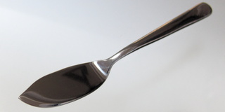

Message #8 Posted by Lyuka on 20 Oct 2011, 5:45 a.m.,
in response to message #7 by Ed Look
Thanks Ed,
It's fairly easy to open the case if you use a special tool for the 'pioneer' ---
A BUTTER KNIFE! :-)
To pull out the four heat stakes behind the [1][2][3] keys,
I had used it as a leverage to make the bottom of the case apart.
FYI you'd better have its edge rounded and polished not to harm the inside part of the housing.
Lyuka
