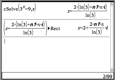

Message #3 Posted by Marcus von Cube, Germany on 12 Mar 2009, 6:39 a.m.,
in response to message #2 by MacDonald Phillips
Here is what the Nspire CAS Mac/PC Software returns:
The second line was created by just selecting >Rect from the menu, Ans has been replaced by the calculator in the history view.
