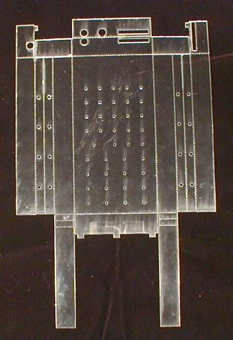

This is the Laser-cut sheet of mylar before cleaning and bending. Note the small circles at each of the key locations. These are small holes to give tactile feedback for the postition of the switch.

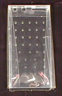

The bent Mylar before installing the calculator circuit board and case bottom.

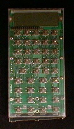

The DIY-RPN circuit board installed in the mylar case but without the graphic overlay installed.

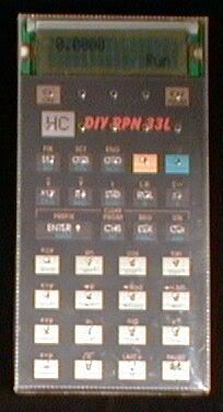

The complete DIY-RPN in a bent Mylar case with a 33L overlay.
