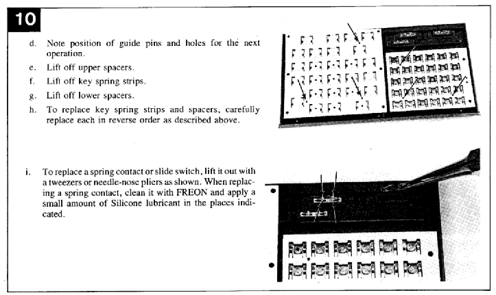

This is what the book [1] says:
**vp
[1] p. 3-15 of the HP-97 Service Manual (file 97serv.pdf in the MoHPC DVD collection)

Apparently somewhere along the way HP changed the stamped sheet. I think they did it to get more bend (and spring) to the contacts. They probably changed the order of the spacers to get keep the contact clearance consistent. If the spacers are in the wrong order you either get swicthes that are shorted closed or never make contact. I know what the service manual says. I also know that most of the machines are actually configured differently. When I first noticed that the spacers were in a different order, I tried fixing them like the manual said. I then started having problems with the keyboards. I just got in two machines last week and both had the spacers together.
